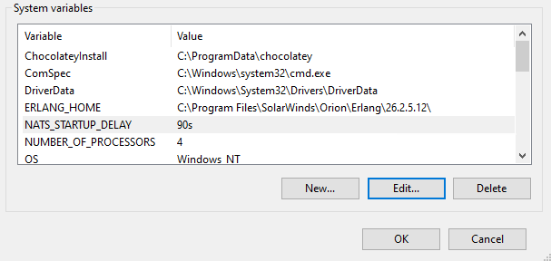

The corrective action is to increase NATS_STARTUP_DELAY so that the SolarWinds Message Bus Service has enough time to finish JetStream initialization before Windows marks the service startup as failed.
Raise the timeout from 30s to 90s, then start the SolarWinds Message Bus Service, wait for the service to reach the Running state, and retest Unmanaged functionality.
  1. Increase the machine-level environment variable NATS_STARTUP_DELAY to 90s on the Main Polling Engine.
  2. Start or restart the SolarWinds Message Bus Service and wait until it reaches Running.
  3. Confirm that NATS is listening on port 5671 and that the Server is in a ready state in nats.log.
  4. Retest the manual Unmanage from the Node Details page.
