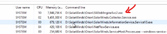

After upgrading to SolarWinds Platform 2024.4, the JobEngineSvc2.exe is generating high memory utilization in the poller server
A known issue in 2024.4 affects the polling engine (Main Polling Engine or Additional Polling Engine) where the JobEngineSvc2.exe process generates high memory utilization.

After upgrading to SolarWinds Platform 2024.4, the JobEngineSvc2.exe process running on the poller engine (Main Poller or Additional Poller), gets high memory utilization.
It usually affects pollers that are monitoring many WMI nodes.
