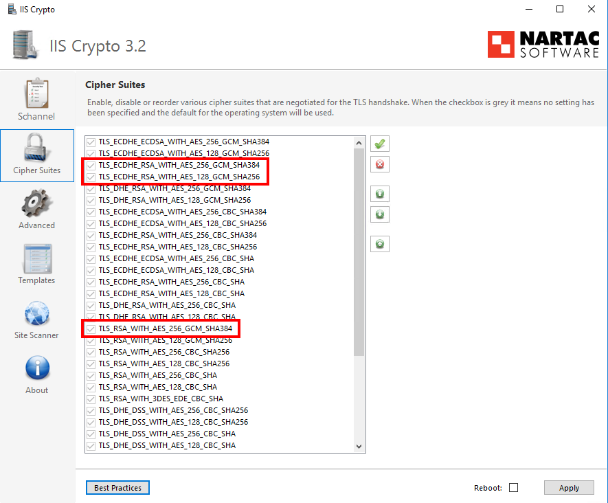

  • At least one of the following cipher suites is not enabled in the collector machine and ARM Server:
TLS_ECDHE_RSA_WITH_AES_128_GCM_SHA256
TLS_ECDHE_RSA_WITH_AES_256_GCM_SHA384
TLS_RSA_WITH_AES_256_GCM_SHA384

Enable at least one of the required security protocols as displayed below, using the following tool:
https://www.nartac.com/Products/IISCrypto/
  • After selecting and applying the correct cipher suites restart the collector machine and/or the ARM Server machine and retry to connect the collector.
