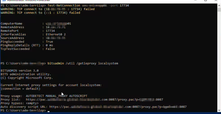

  • From an elevated PowerShell / CMD on the main polling engine:
netstat -ano | findstr :17734
  • The output should be the following:
TCP    [::1]:XXXX            [::1]:17734            LISTENING        17488
  • Confirm that port 17734 is in a LISTENING state.
2. Ensure loopback traffic is not intercepted or redirected
  • Review configuration for any local web proxies, endpoint security agents, or traffic-filtering software installed on the SolarWinds server.
    • A proxy on the system account could redirect traffic to a different endpoint. Check these registries:
      • Computer\HKEY_USERS\S-1-5-18\Software\Microsoft\Windows\CurrentVersion\Internet Settings
      • Computer\HKEY_LOCAL_MACHINE\SOFTWARE\Microsoft\Windows\CurrentVersion\Internet Settings
      • Computer\HKEY_CURRENT_USER\Software\Microsoft\Windows\CurrentVersion\Internet Settings
    • In case the above registry does not show any configured proxy settings, you can run this command to validate if a third-party proxy is running in PowerShell:
      • bitsadmin /util /getieproxy localsystem
  • Exclude or bypass:
    • Traffic to localhost:17734
    • Traffic to[::1]:17734
    • Run this command in PowerShell:
      • bitsadmin /util /setieproxy localsystem NO_PROXY

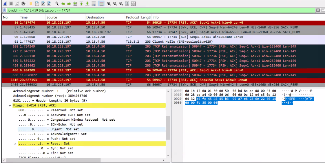

1. Verify that TCP port **17734** is open. If the port is open, run a Wireshark capture on the affected APE/AWS server.
2. Apply the following Wireshark filter:
   `ip.addr == xx.xx.xx.xx && tcp.port == 17734`
   (Replace `xx.xx.xx.xx` with the IP address of the affected server.)
3. The Wireshark capture above shows that port **17734** is open, but the session is being reset immediately after the connection is established.
4. In my case 02156098 , the customer confirmed that their security team observed that the **SSL App-ID** was not allowed along with port **17734**. After permitting the SSL App-ID, the issue was resolved.
