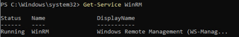

  1. Open PowerShell and run "Get-Service WinRM" to determine the status of the service. This should return a status of Running:

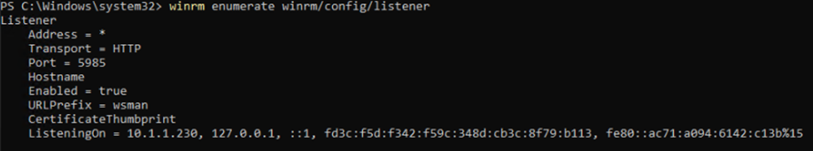

  1. Run "WinRM enumerate winrm/config/listener" to confirm the service is listening:

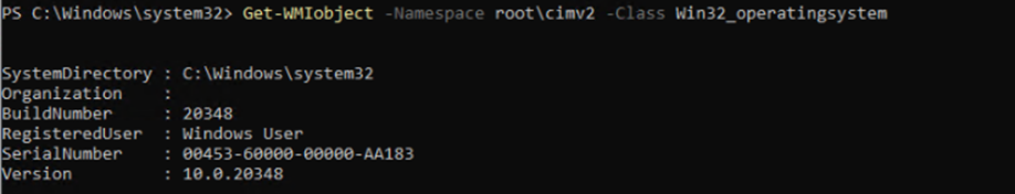

    1. Run "Get-WMIObject -Namespace root\cimv2 -Class Win32_operatingsystem" to confirm WMI is running.

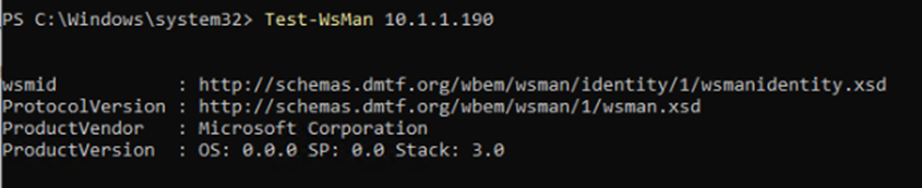

    2. Test WinRM communication to the target node using PowerShell:
      1. Test-WSMan <NodeNameorIPAddress>

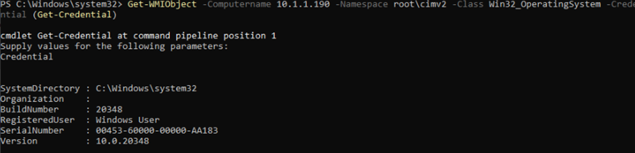

    1. Test WMI Remotely via PowerShell with the following command:
      1. Get-WmiObject -ComputerName <ServerName> -Namespace root\cimv2 -Class Win32_OperatingSystem -Credential (Get-Credential)
