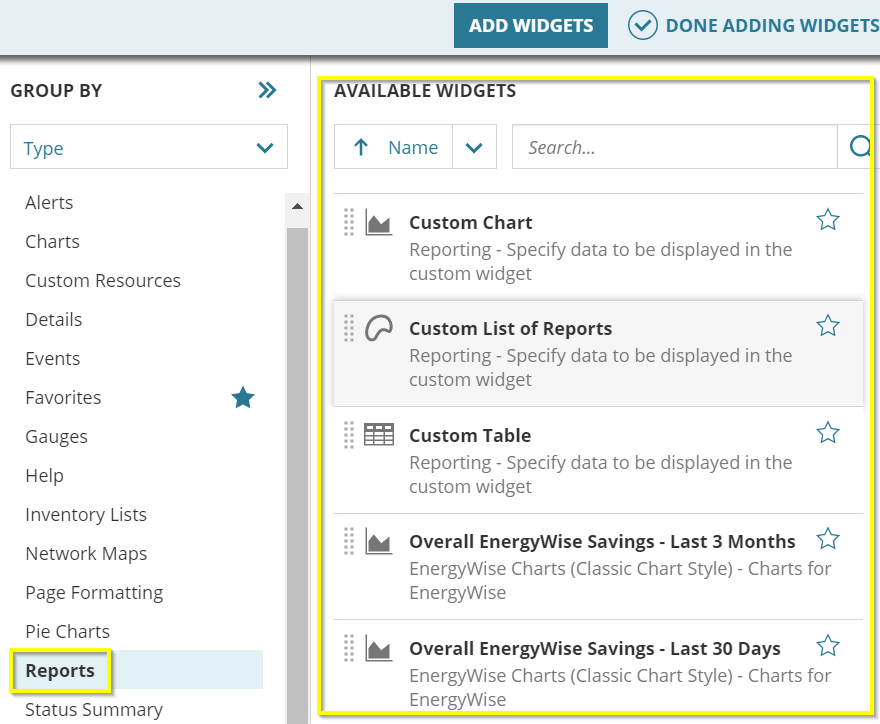

  3. Click Add Widgets Button
  4. A selection pane will be shown upon selecting Add Widgets. Find and select Reports. On the right side of the selection pane a list of Available Widgets will be shown under Reports. Select the appropriate widget which fits to the existing report. Drag the chosen widget(s) to place them on the Summary page.add report widget
  5. After adding the widget(s) click Done Adding Widgets and click Done editing.

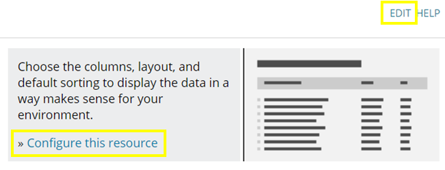

  6. Find the widget(s) on the Summary page that you want to edit. Click Edit or Configure this resource.edit widget

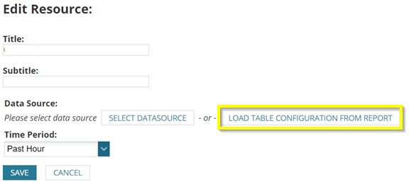

  7. Select Load Table Configuration to load the data from the existing report. After selecting Load Table Configuration a list of selection will be shown, find the existing report from the list that you want to display. Click the Use button which can be found on the bottom of the selection.                                                                                                  edit resource
  8. Press Preview Resource button to see the preview of your report. This will show how it will look like on your Summary page.
  9. Once satisfied about the preview of your report press the Save button.
