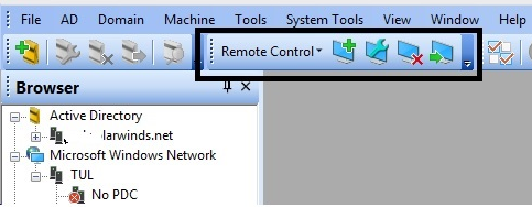

This article describes how to add the Mini Remote Control shortcut in the Dameware Remote Support (DRS) standard toolbar.
Dameware Remote Support & Mini Remote Control

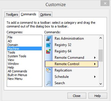

  1. Open Dameware Remote Support.
  2. Right-click the blank space in the Remote Control toolbar and click Customize.
  3. Click the Commands tab.
  4. In the Categories column, select Machine.
  5. Click and drag Remote Control to the standard toolbar.
    Remote Control displays in the Commands menu.
  6. Click Done.
