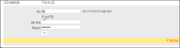

When you open the Orion Web Console and add a Cisco Unified Computing System (UCS) device using the UCS API, the credential test fails even though the credentials are valid.

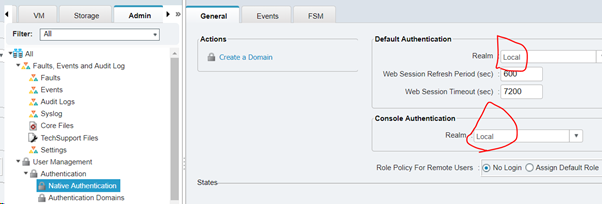

Verify the LDAP authentication
Confirm that LDAP authentication is not enabled on your UCS device.

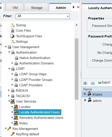

  1. Open the UCS Manager.

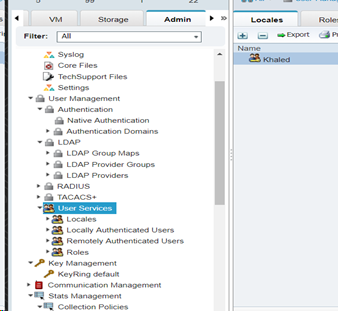

  2. In the left pane, click the Admin tab and expand User Management.
  3. In the Authentication tab, verify that Native Authentication is set to Local.

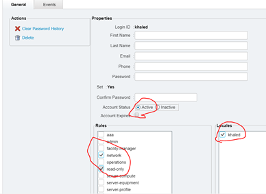

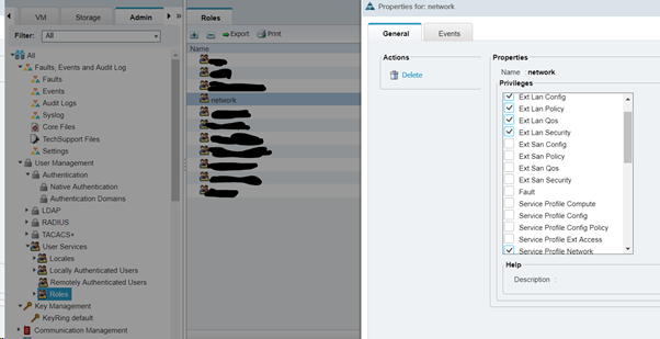

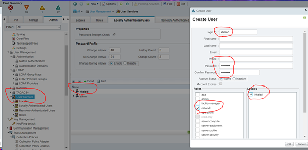

  4. Verify that the user has the correct privileges to poll the data from the UCS to the Orion server.
    Note: If the default authentication realm is anything other than Local, use another realm for local authentication. Authentication should use the full username form. For example: ucs-realm_name\username (ucs- should always be included).

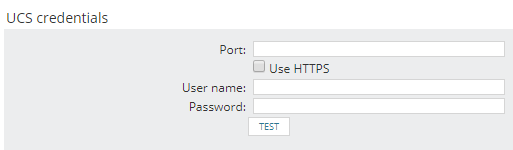

  6. Next to Additional Monitoring Options, select UCS Manager credentials.
  7. Under UCS credentials, complete the fields.
  8. Click TEST.
    If the test does not pass, check your credentials.
    If the test passes, click Next to continue.
  9. Complete the wizard, and click Submit.
