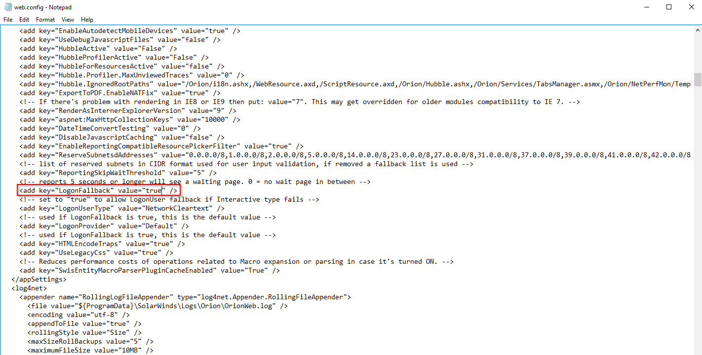

Resolution 3:
  • Enable LogonFallback on the web. config file in C:\inetpub\Solarwinds:
