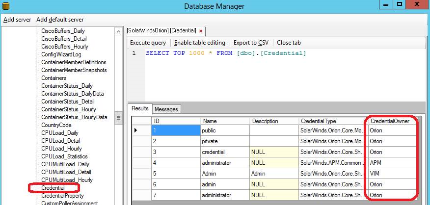

  1. Check the database manager and query the Credentials table
Here you’ll see a list of account, find the account and check the credential owner column. On this example “administrator” is being used by APM which is SAM.
On a customer environment you’ll find a lot of names here. If the account is being used by the SolarWinds Platform you can find that in the Manage your credential field and change it there.
Settings > Credentials > Manage Window credentials

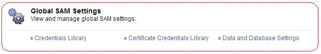

Now if it’s SAM, you’ll find it in the SAM credentials library on
SAM Settings > Global SAM Settings > Credential Library

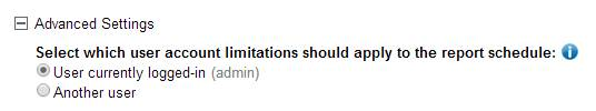

You can also find it on Orion Report scheduler. Just edit the schedule and go through the advanced settings

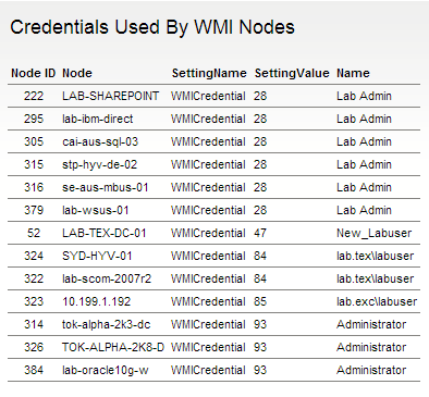

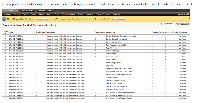

You can also check these (2) reports which should show you Credentials being used by WMI Nodes (at the NPM level) and what's being used at the APM/SAM level
CREDENTIALS USED BY WMI NODES
https://thwack.solarwinds.com/docs/DOC-172320
CREDENTIALS USED BY APM COMPONENT MONITORS
https://thwack.solarwinds.com/docs/DOC-160488
To use these download the .OrionReport and then copy them into this path on your Orion/NPM Server
--> C:\Program Files (x86)\SolarWinds\Orion\Reports\
Then go back to your SolarWinds Platform Web Console > http://<orionservername>/Orion/Reports/Default.aspx
Then search for the word "Credentials" and you should find both:
Then put a check mark next to the one you want to view and then click > VIEW REPORT
Your output should look like these:
