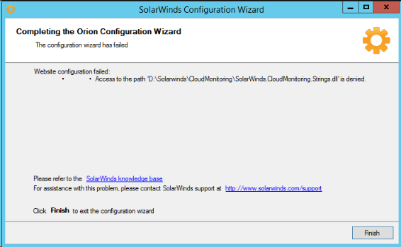

The Configuration Wizard displays the message,
Website configuration failed:
Access to the path 'C:\Program Files (x86)\SolarWinds\Orion\CloudMonitoring\SolarWinds.CloudMonitoring.Strings.dll' is denied.
    Or other similar messages
        •      •  Access to the path 'E:\Program Files (x86)\SolarWinds\Orion\SolarWinds.AgentManagement.Contract.dll' is denied.

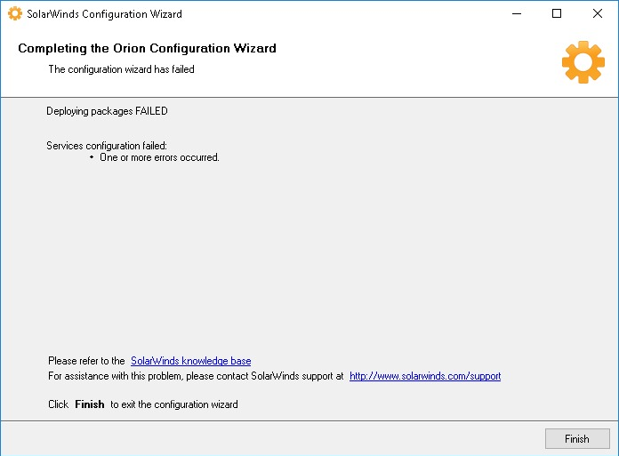

    Deploying packages failed:
    Services configuration failed:
    One or more errors occurred.
