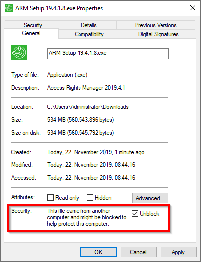

  • The setup file may be flagged as an untrusted copy from the Internet. If prompted, allow the installation.
    • Call up the properties of the setup file.
    • Under the General tab, Security: enable Unblock.

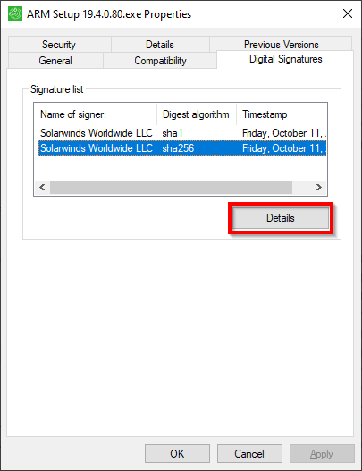

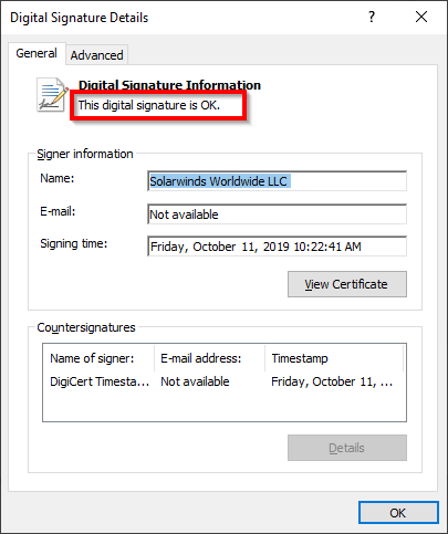

    • The setup must also have a valid digital signature. Otherwise, the root certificates are out of order, or there is no Internet access to update.

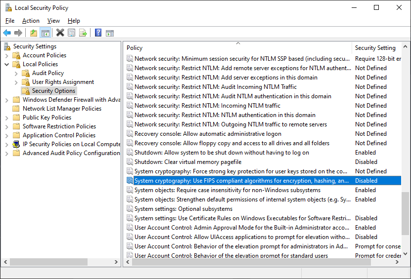

  • FIPS compliance must be disabled for the installation to be successful.
Open the Local Security Policy console. Go to Security Settings > Local Policies > Security Options > System cryptography: Use FIPS compliant algorithms... > set to DISABLED.
