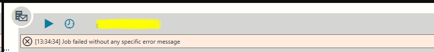

ARM Exchange Scan job fails with unspecific Error
ARM Exchange Scan Job failed without any specific error message
