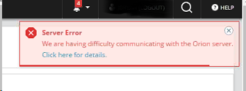

One of the APEs is showing as down and HA Status is showing partially operational. You see following error message in the Orion Web Console whenever you navigate to some links in settings or try to do a failover test: Server Error We are having difficulty communicating with the Orion server.
Server Error
