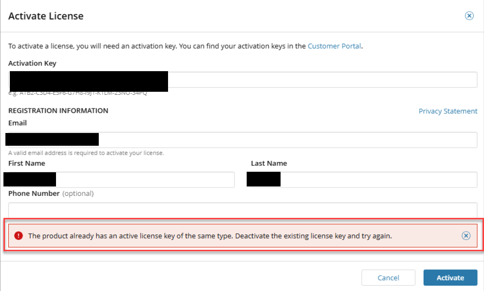

This error 'This product already has an active license key of the same type. Deactivate the existing license key and try again.' occurs in SolarWinds Platform / Hybrid Cloud Observability (HCO) / Observability Self-Hosted environments that use the central licensing service when you try to add an unexpired temporary or evaluation key for a product that already has an unexpired commercial license of the same type (for example, Additional Polling Engine (APE) or AWS pollers). It has been observed in customer environments running 2025.1.1, 2025.4.1, and 2025.4.2 and later.
Observed symptoms
  • In License Manager, activation of the unexpired temp/eval key fails with an error and the key is not added.
  • License service logs show license detail requests for the key but do not clearly indicate that a safety check blocked activation.
  • Once the environment is on an affected build and these conditions are met, the failure is consistent.

A licensing code change introduced a safety check to prevent accidental replacement of active commercial licenses with temporary or evaluation keys.
When you try to activate an unexpired temp/eval key for a product that already has an unexpired commercial license of the same type, the safety check blocks the activation, shows an error, and the temp/eval key is not applied.
This behavior is controlled by the advanced admin setting BlockActivationIfAlreadyLicensed. When it is enabled, temp/eval keys are blocked if a matching unexpired commercial license already exists. This safety check is intentional and discussions are in place to refine it in a future release so customers can safely use temporary capacity (such as APE/AWS temp keys) without running into this block.
