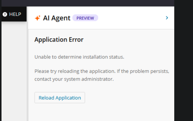

AI Agent shows “Unable to determine installation status”
After enabling the AI Agent and enabled the Platform Connect the agent status is showing connected, but an Application Error message appears when the AI Agent preview is started.
8/6/2026 9:13 PM
8/6/2026 9:13 PM
AI Agent application error where the page shows “Unable to determine installation status.”
Orion Platform
The issue can be caused when Platform Connect is configured with an ingestion token instead of an API Access Token.
  1. Open the Platform Connect Wizard.
  2. Start the process to update or reconnect the Platform Connect configuration.
  3. Generate a new API Access Token in the SolarWinds Observability tenant.
  4. Use the new API Access Token in the Platform Connect Wizard.
  5. Complete the wizard and allow the connection to finish updating.
  6. Return to the AI Agent page and refresh the page state.
