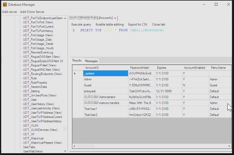

Run the following query to locate your account:
SELECT TOP 1000 * FROM [dbo].[Accounts]

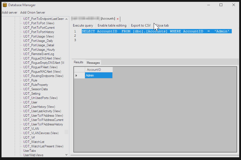

If you already know the name of the account, you can use the following:
SELECT AccountID  FROM [dbo].[Accounts] WHERE AccountID  =  'Account Name here '
