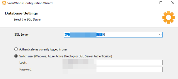

Run Configuration Wizard, and instead of indicating the hostname or FQDN of the SQL server, input the IP address
Kindly follow this format:
tcp:sqlipaddress,portnumber
tcp:x.x.x.x,pppp
Sample Image:
NOTE: Ensure to run Configuration Wizard on "Database", "Website" and "Services".
The reason behind this is that there are SQL connection strings within Website and Services; thus, there is a need to run against all 3
It also exhibits an issue with DNS in your environment, and you should be working on rectifying it. If there is a need (in the future) to leverage DNS for failover, etc., there will be issues.
