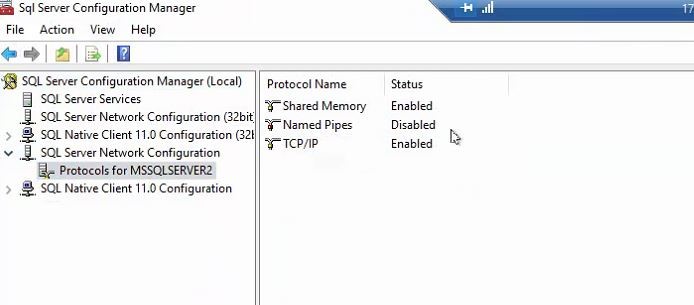

  1. TCP/IP was not enabled in SQL server Configuration Manager.
  2. Wrong SQL server hostname/IP entry in C:\Windows\System32\drivers\etc\hosts
Option 1:
1. Remote into machine that SQL is installed on.
2. Open SQL Server Network Config
3. Open Protocol for MSSQLSERVER2
4. Enabled TCP/IP
5. Rebooted server
