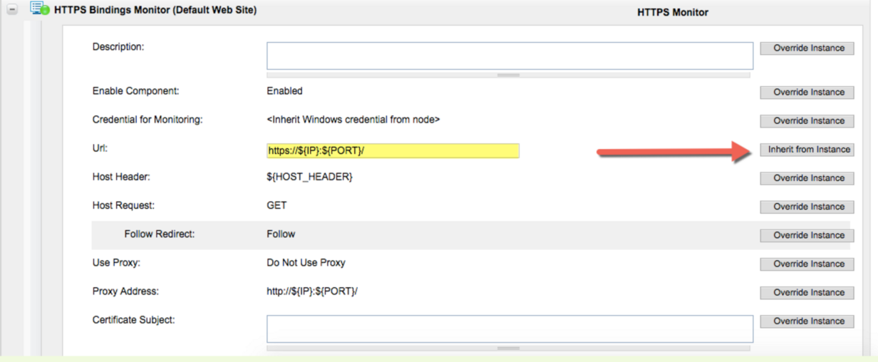

Resolution 2
If the above resolution doesn't work you may also try to change the URL to a valid one.

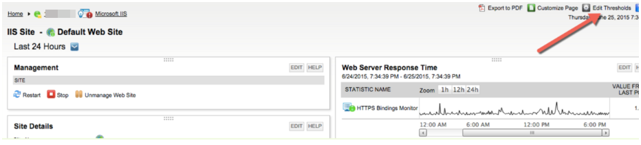

1. From the Site Details view of the website that returns a 403 response when monitoring the root click "Edit Thresholds"
2. From there expand the HTTP or HTTPS Bindings Monitor (Site Name), click "Override Instance" for the URL setting and edit the URL parameter with a URL that works for that site.
