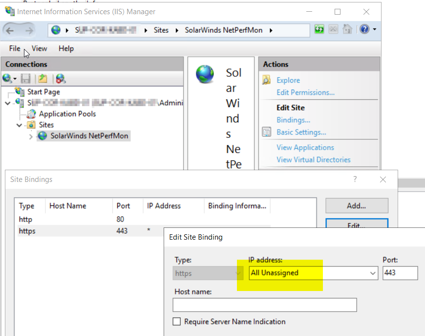

Make sure that the Orion website is listening on all IP addresses:
  1. Open IIS Manager.
  2. Go to Sites > SolarWinds NetPerfMon.
  3. Click on Bindings.
  4. Edit all bindings and make sure that IP address is set to All Unassigned for all of them.

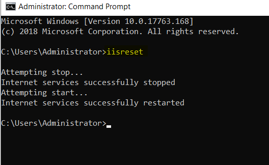

  1. If you made any changes, restart the website. Or run the below command:
