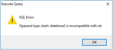

When running a report in the deprecated Report Writer the report will fail with the error below.
ERROR:
SQL Error:
"Operand type clash: datetime2 is incompatible with int"
