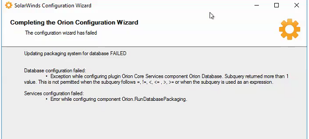

The Configuration Wizard has failed
Updating packaging system for database FAILED
Database configuration failed:
 •  Exception while configuring plugin Orion Core Services component Orion Database. Subquery returned more than 1 value. This is not permitted when the subquery follows =, !=, <, <= , >, >= or when the subquery is used as an expression.
Services configuration failed:
    •  Error while configuring component Orion.RunDatabasePackaging
OR
  • Error while executing script- Subquery returned more than 1 value. This is not permitted when the subquery follows =, !=, <, <= , >, >= or when the subquery is used as an expression.

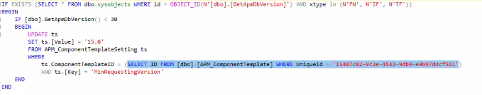

  • Before the error message, there will most likely be a list of SQL statements that look something like the screenshot below.
  • You will need to open SQL Server Management Studio (SSMS) connecting to the SQL server where the Orion database is located, and access it with credentials that are able to make changes to the database.
  • Once in SSMS, you will need to run each of the SQL statements found in the Configuration Wizard, before the specific error, until you see the same error as a result of the query being submitted.
  • Once you have identified the SQL statement that provides the same error, run the Select statement where it references the ID is to find the duplicate values.
  • Then delete the second ID. For example, if the statement above caused the error and the duplicate entry had the ID as 8188 then the delete command would go something like this:
DELETE FROM [dbo].[APM_ComponentTemplate]
WHERE ID = '8188"
  • Then re-run the Configuration Wizard.

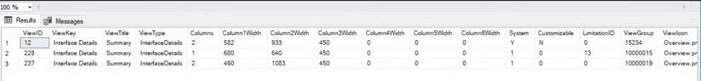

Upon verifying, the subquery SELECT ViewGroup FROM Views WHERE ViewKey = 'Interface Details' returned two results
SELECT * FROM Views WHERE ViewKey = 'Interface Details'
update views
set ViewKey = 'Interface_Details'
where viewid = 14
Kindly see the sample screenshot below of the results.
  • Renamed one of the ViewKey from 'Interface Details'  to 'Interface_Details'  for the ViewID that does not show ViewGroupID: 15234. From the screenshot above, it would be ViewID: 228 and View ID: 237.
  • So that the subquery returned only one value
  • Re-run the Configuration Wizard
